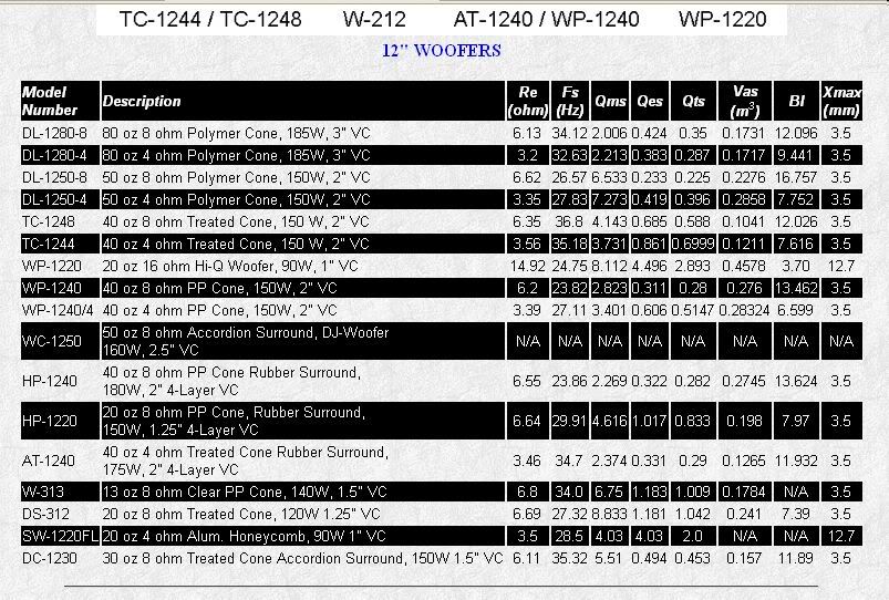

some specs....
look at WP-1220 and SW-1220FL

Thank you members for your help of the specs....
They are electrical and mechanical infos....
If i can find some details of the original Foam surround's specs....hope that will help for making new Butyl Rubber surrounds instead.
Pls help.

Well, look at that huge Xmax number (in mm). That's essentially half of the travel the cone needs to move (half the voice coil length). Any surround that limits that movement will not make a good substitute.
And from that info a speaker manufacturer will be able to figure out what the surround should be.

BillD wrote:Well, look at that huge Xmax number (in mm). That's essentially half of the travel the cone needs to move (half the voice coil length). Any surround that limits that movement will not make a good substitute.
I bet this is why I have blown so many fuses on my first pair over the years. The foam I had a local shop put on is closer to rubber egg carton than soft glove. It got them working, but at a stress price.
