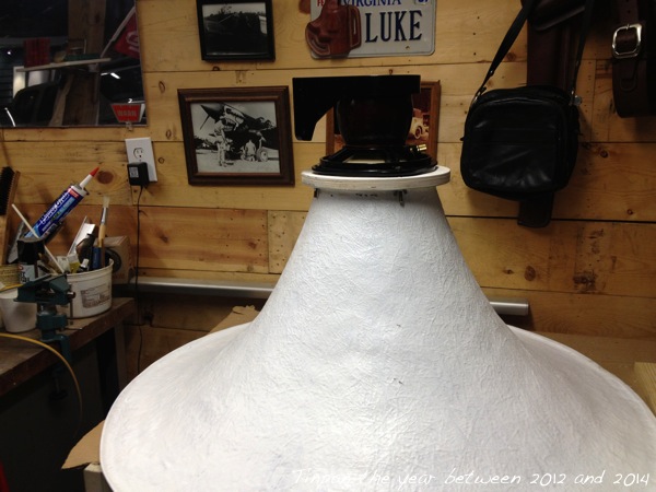

Monday was a good day, I finally figured out how to mount my PM4a drivers. Now to let the adhesive that glues the flange to the horn dry for a week and I'll be ready to finish the stands for these
The trick was to drill the holes large enough to let the bolts have some slop so you can wiggle everything into position. I was trying to make everything an exact fit and that wasn't working
Installed the flanges on the wings for the horns. Now to wait for the turnbuckles to show up and the drivers and these will be ready to go
