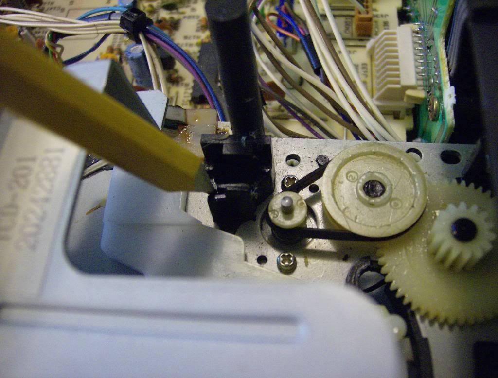

the belt is slipping, looky here....
drawer catch tab
other drawer catch tab, these are plastic, be careful these can break
when the drawer is open you will see that the tray hits these, bend the tab a bit and the tray will slide out, this lets you get the the belt.
when you get a new belt,pop the top, it takes 5 mins to change

So you push the tabs in and 'force' (lightly push) the drawer open? Does it matter if the unit is plugged in for this (as I'm guessing this is open manually)?
Carver TFM 4.0t, Carver 490t CD Player, Audio Research LS1 Preamp, Audio Research Classic 60 amp, Klipsch Chorus and Martin Logan CLS Speakers.
Posts: 1679
Post Sat Jul 24, 2010 10:43 pm
Re: Just Bought 490t CD Player- Help!
no I had it unplugged and spun the motor by hand, yes just lightly push the catch to the side.

Thanks for the informative pics! I got the tray out successfully without incident. Now, where is the best place to get a replacement belt?

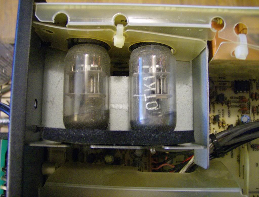

are the tubes in there....
Texas42
Posts: 36
Joined: Wed Jun 29, 2005 1:10 am
Location: San Antonio, TX
Post Sun Jul 25, 2010 8:59 pm
Yes, both tubes are in it and both are glowing so I assume they are working.
